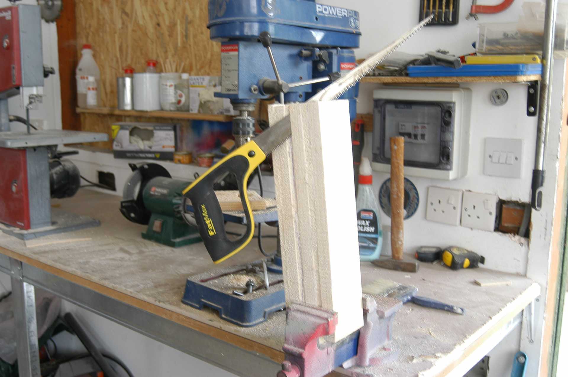

I need a canon on the front, thought about what I could make it from, so decided to do it in fibre glass
So got some chemi wood and started carving
I drilled indents where the holes will go, put some black paint in them so they would show up
Gave the plugs and coat of resin

Loving the cannon, great bit of building.
you have certainly got the building bug again Tony.

I do hope you are going to glass-up that cannon in two halves - otherwise those drilled indents will not let the cast off the plug! :evil:
  • THE BLACKBIRD
  • THE BLACKBIRD's Avatar Topic Author
04 Apr 2017 21:41 #157 by THE BLACKBIRD
Replied by THE BLACKBIRD on topic The Cyprus A10 THUNDERBOLT
yes Eric that was the intention
