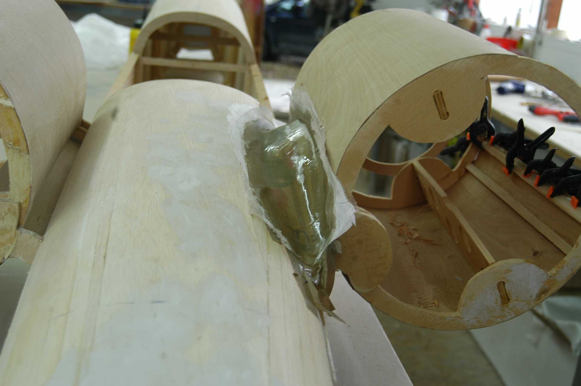

31 Mar 2017 19:50 #140 by THE BLACKBIRD

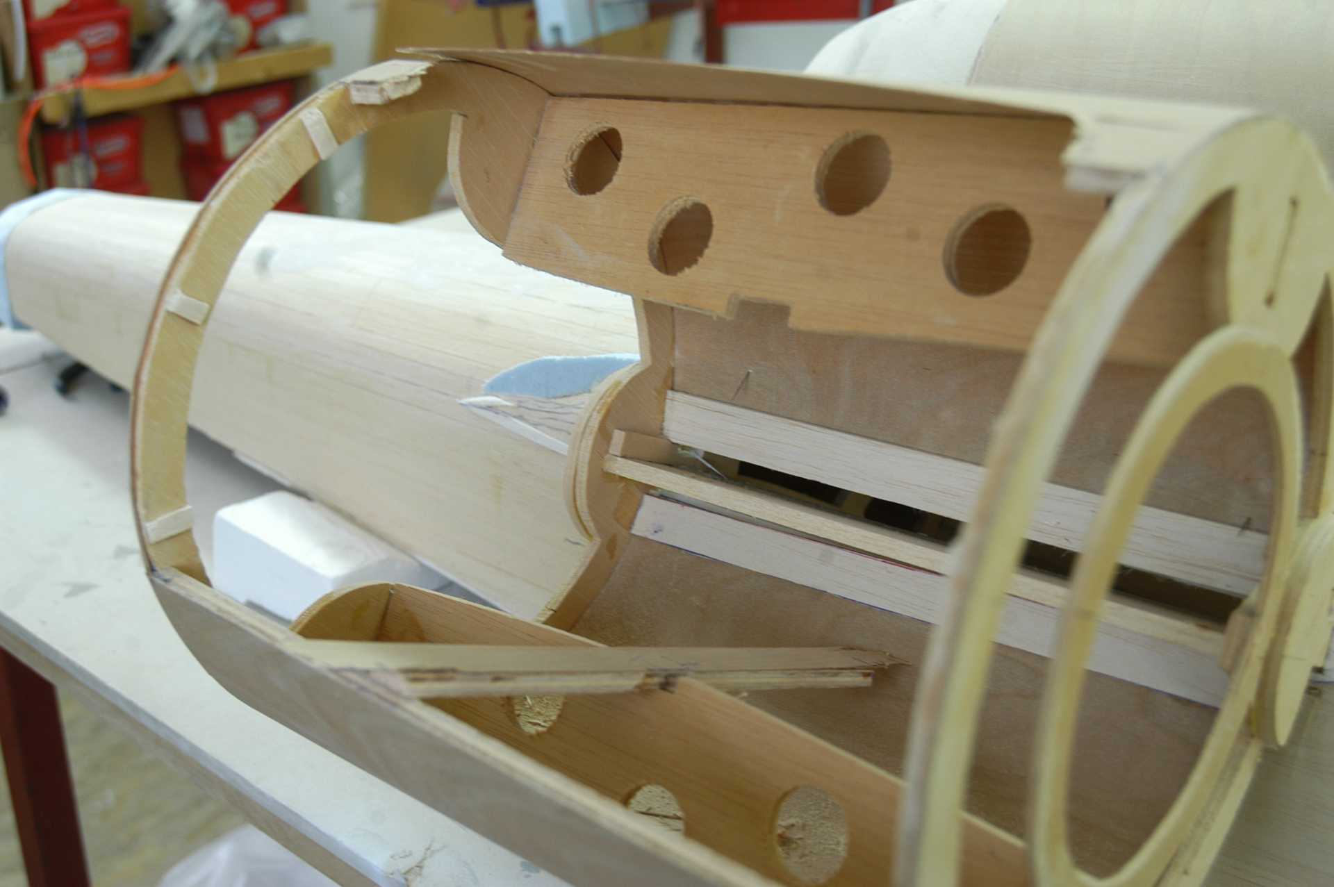

Hi John I know thank you, but I wanted to use these bloody hinges I have,
Anyroods I pressed on ripped the hatch off
And binned it then started to make and fit a new one using the hinges I had because I had worked out how to do it :P
Only when I had done it IT WOULD NOT OPEN :angry: :dry: :woohoo:
Sooooo version 3!!!! using the new hatch and with a bit of hacking and cursing, could not get the other apart so finished up with damage, but it will repair, and I cannot afford to waste any more of this ply as I only have enough for the other hatch and will not buy more @ 56 quid a 1200 + 600 sheet +carriage
Using a tube I have it working
And I managed to slice open 3 finger and a thumb all in one go :S
Just not safe to be out of bed at the moment :whistle:

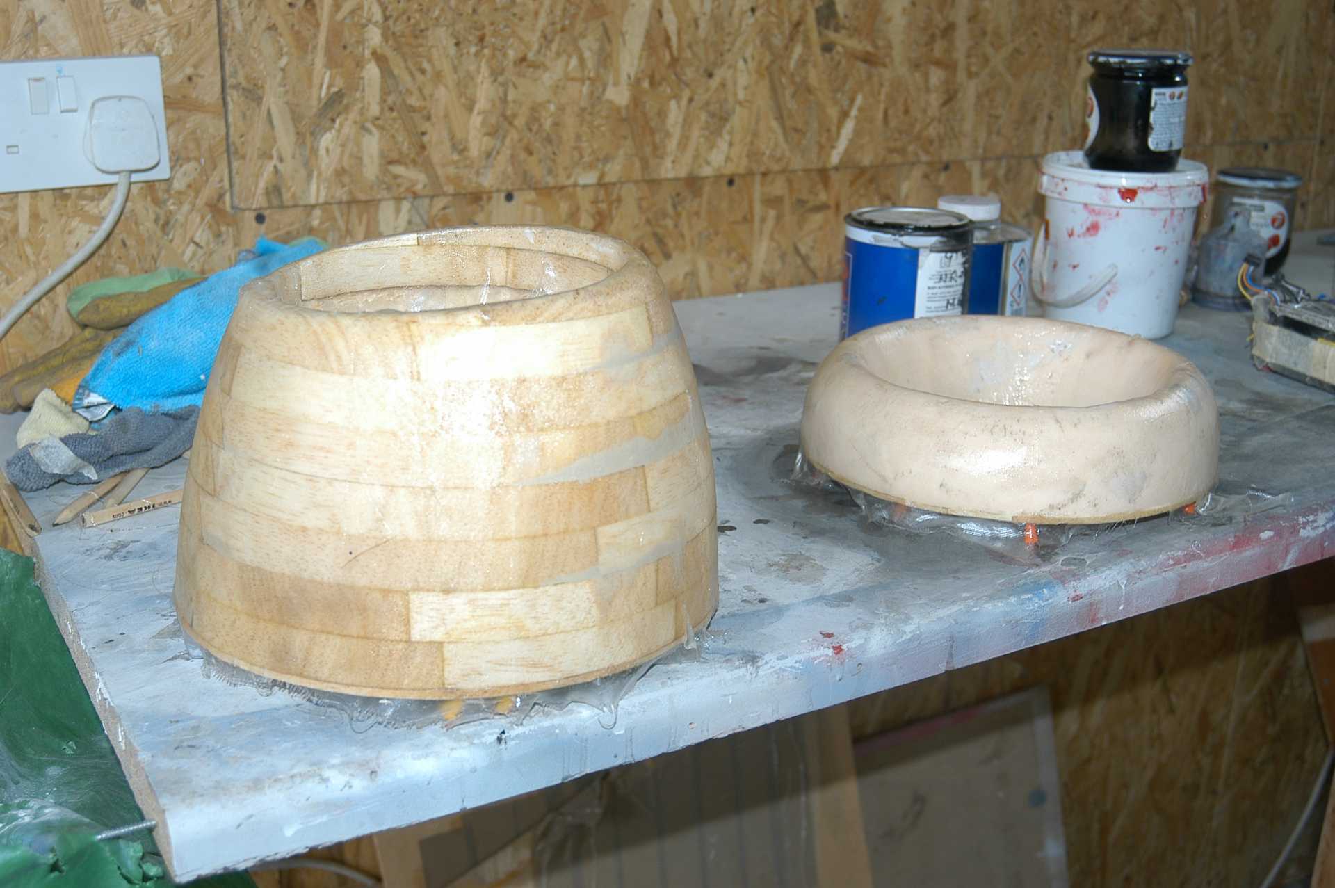

01 Apr 2017 19:22 #148 by THE BLACKBIRD

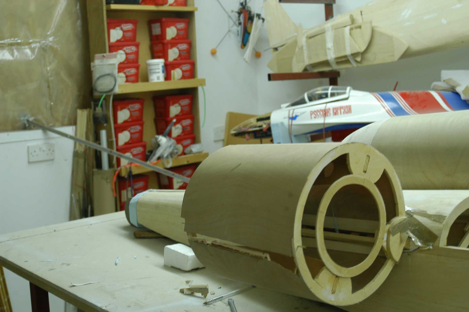

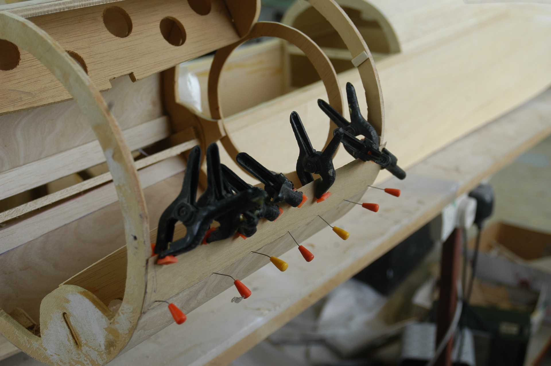

Started the repairs this morning where I destroyed it getting it apart :(
And here is the finished hatch all working, with todays blood on it, they say they fly ok if they have blood on them, this should be a cracker with all of it I have shed on this one :lol: I bushed the brass tube where it hinges and I fitted two powerful magnets to keep it close,, ill work something out to open it later :)
Tonight I started on the other one hopefully this one will go a bit quicker
At the third attempt I did the fairing between the fuselage and engine housing
Cut the plugs off the housing and glassed them

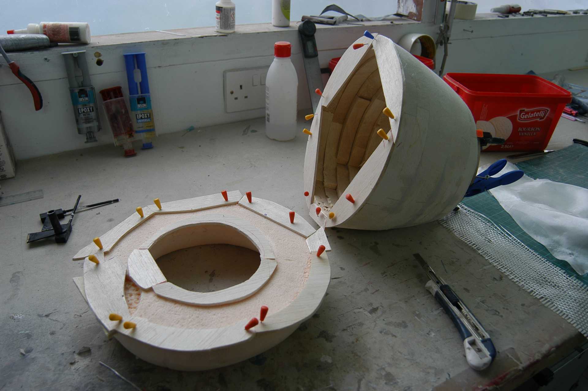

01 Apr 2017 19:29 - 01 Apr 2017 19:32 #149 by THE BLACKBIRD

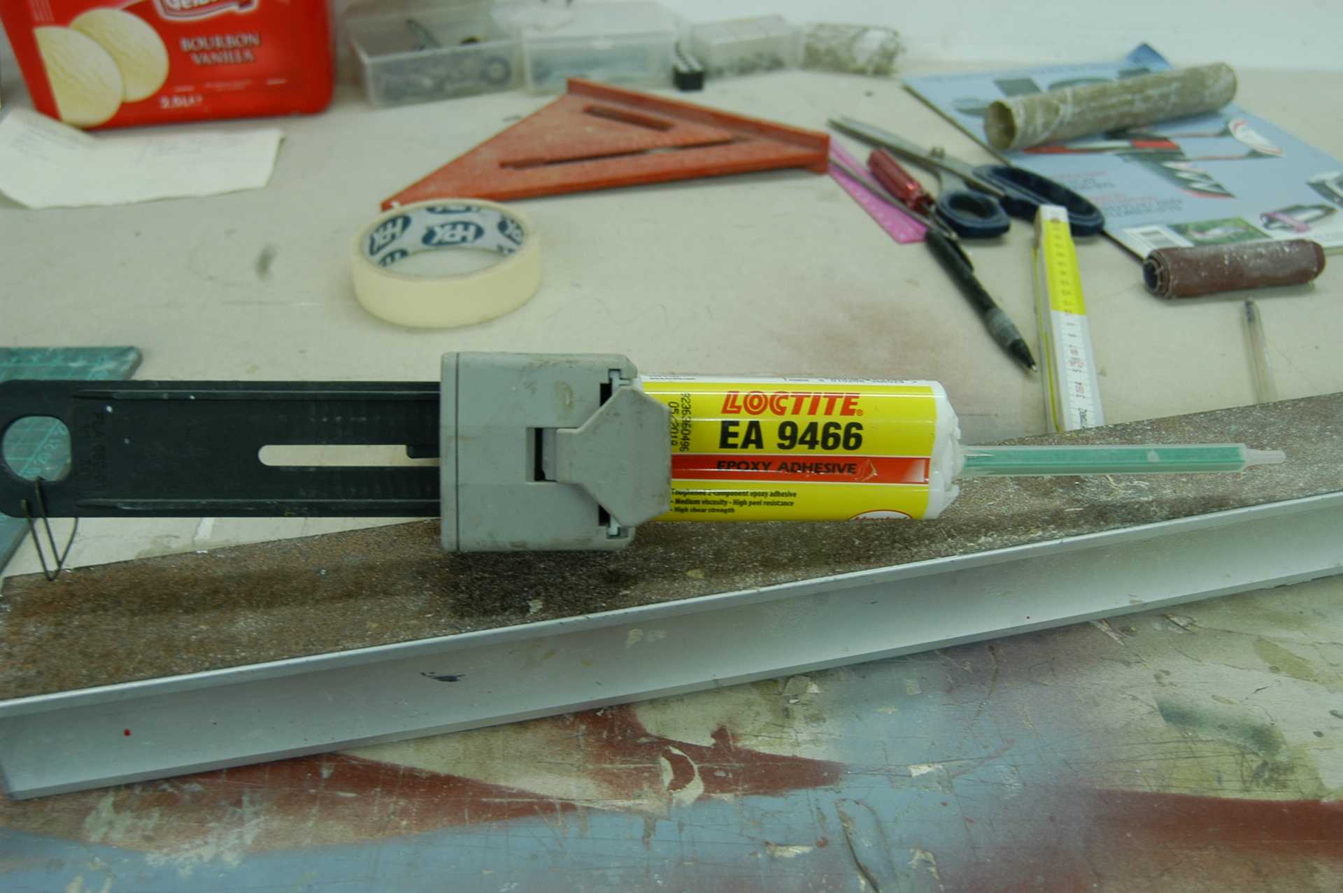

Hers my Hysol
Been using it tonight to glue the magnets in, I don't use the nozzles unless it in a difficult place to get at, squeeze it onto a piece of cornflake packet an mix it, otherwise what is in the nozzle is wasted

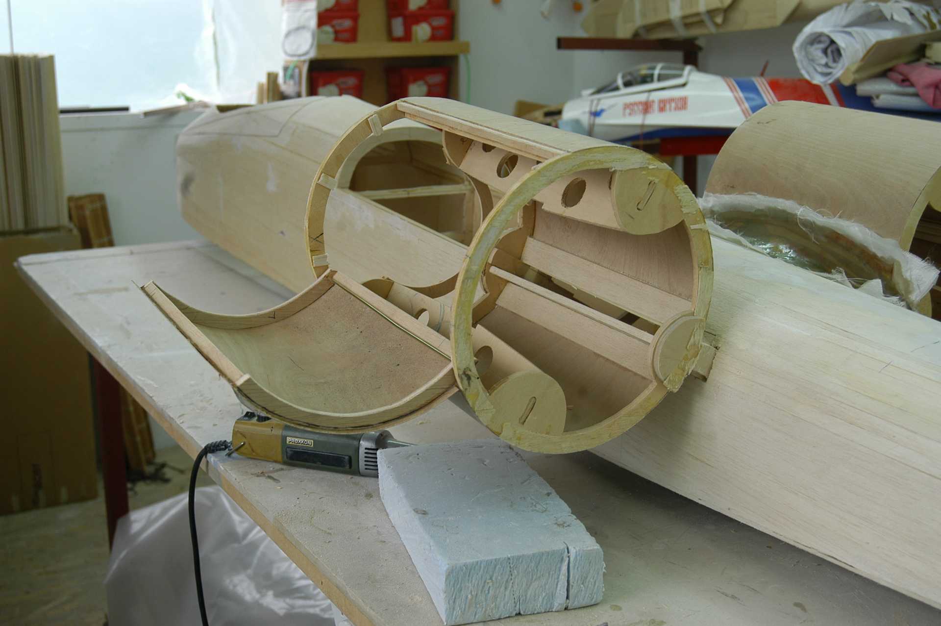

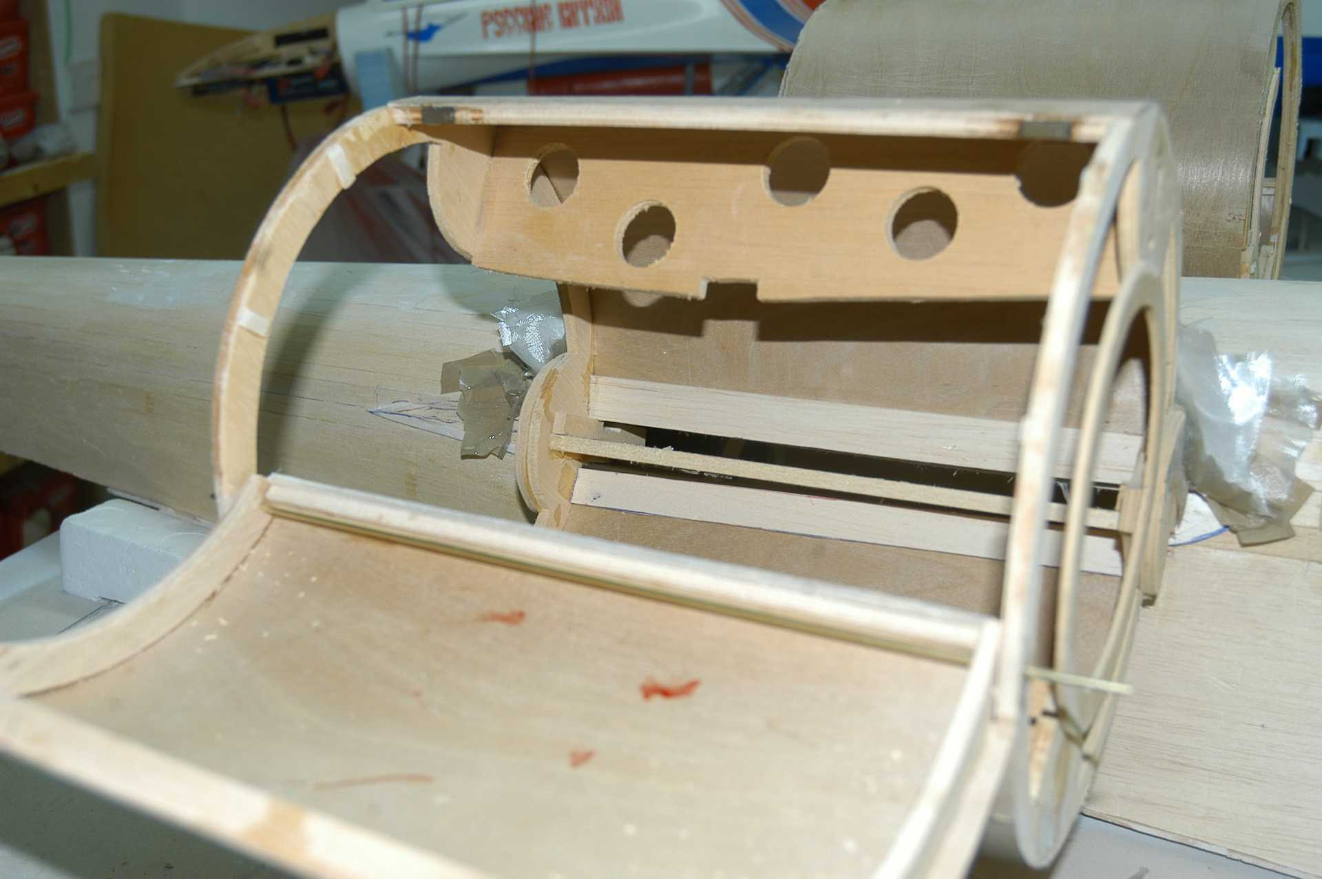

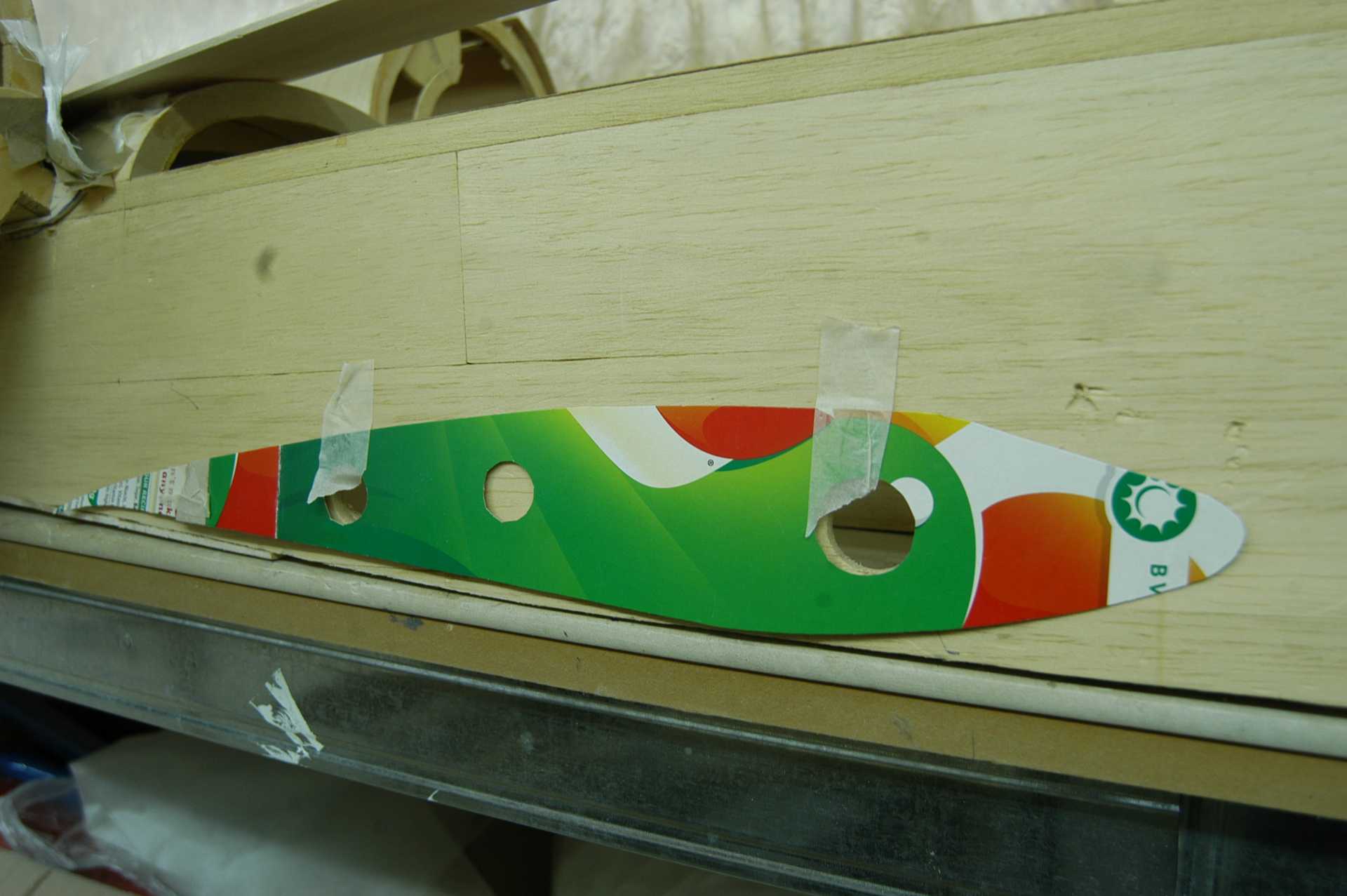

02 Apr 2017 19:57 #150 by THE BLACKBIRD
Got the other hatch done in a couple of hours this morning :)
Been trying to work out the wing section quite an unusual shape
As im building it by looking at the 1/48th plastic model I have, and I have lost a whole load of parts
god knows where they are, things could get difficult :(
