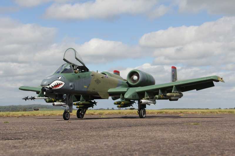

My new build for the winter, might even get started before, the building that is, the planing has already started.
Spec.
Scratch built
Wingspan 2850mm. length 2600MM. weight around 35lb. for EDF.
Just like this one, discount price from Skymaster Jets £5700 that's just for the airframe
Watch this space for the build blog
