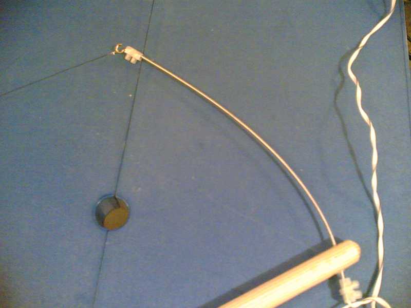

THE BLACKBIRD wrote: Next time ill make a proper one Klipy and yes it went a bit slack when i used it, as you can see by the foam, another lesson learned, see what i mean Dean
if you dont have a go you will never do it.
Dead easy to make BB ... Here's one end of one of mine. Instead of using wooden dowel, use some heavy piano wire & you've got an automatic tensioner.
I used a wooded brush handle for the main body of the bow on this one .... I've also made them from plastic pipe from any DIY shop.
The most important thing is to use the correct wire though .... you need something with a bit of electrical resistance .... NICHROME wire is probably the best. It's the sort of thing they use on the old style electric fire elements & is very cheap.
It's no good just using something like a guitar string .... you need to pass a lot of current through it to generate any heat ..... & the connecting cable gets hot.
The bow in this picture will cut widths up to about 40 inches & will run on 22 - 24V & only pulls about 1 - 2 Amps.
I use power supplies, lead acid batteries .... or even get an hours continuous running on two 3S 1800mAh lipo's in series.
I even run it through a footswitch so I don't keep burning things when I put it down. :lol:

Thanks Pol that looks the biz, all i need now is to find some foam over here there must be some somewhere, but god knows where,

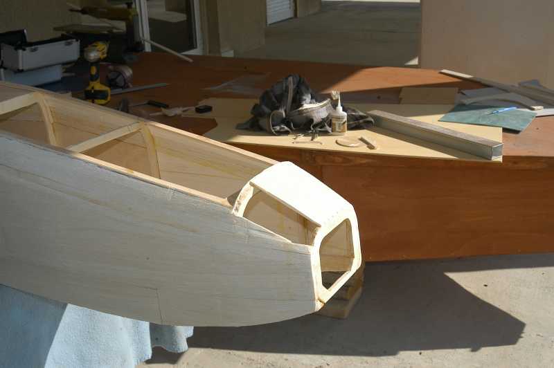

I was not happy with the standard of woodwork on the nose of the A10 so i pulled it of this morning and did it again
Starting to take it off
And the new, a lot better

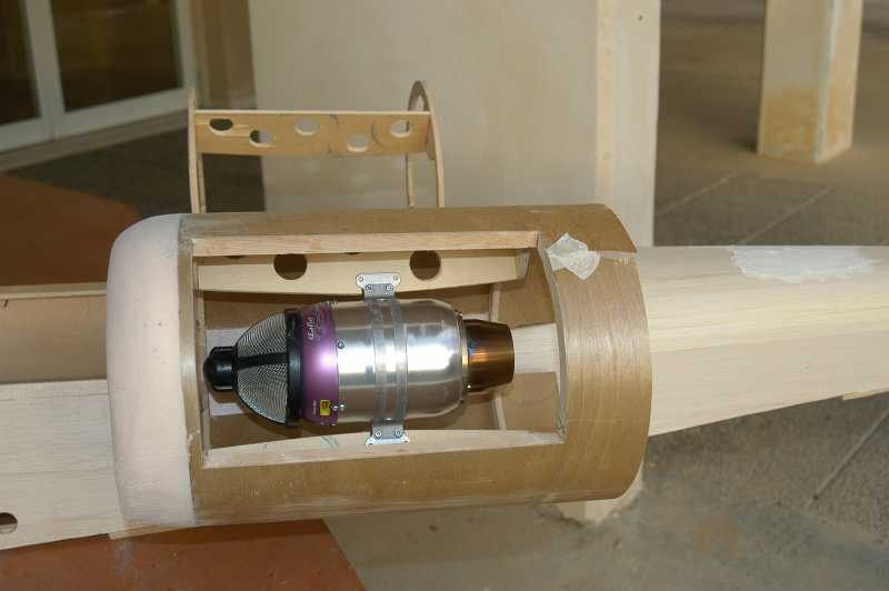

Then i changed my mind about lining the inside of the nacelle,think it's best left with space around the turbine

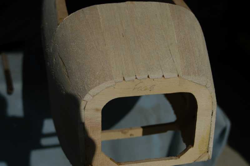

I added a former to the front of the nacelle for the inlet air hole

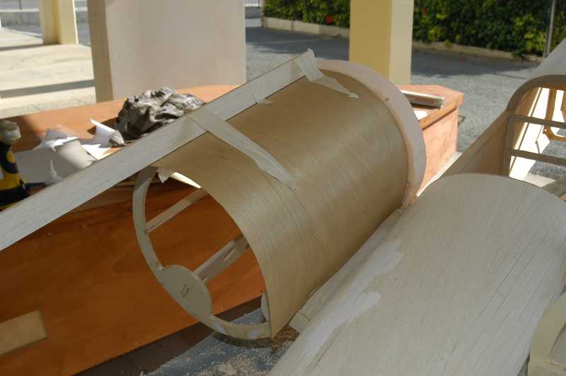

Then i put the outer ply skin on

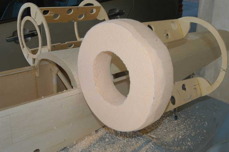

Got some more of Pol's foam and started the front moulding round the intake, still working on the final shape inside the moulding

I think that foam will only stand about 130oC ..... you could skin that orange foam with fibre glass just in case.
01 Dec 2012 03:04 #99 by old fart
Replied by old fart on topic Re: The Cyprus A10 THUNDERBOLT
That is the cold end Phil, it will be just fine. :)
01 Dec 2012 05:52 - 01 Dec 2012 05:53 #100 by THE BLACKBIRD
Replied by THE BLACKBIRD on topic Re: The Cyprus A10 THUNDERBOLT
I was going to fibre glass it anyway but as Owen said it's the cold end, the hot end i think will be balsa also fibre glassed, the exhaust gasses are around 800deg i think , is that right Owen so it will need a exhaust pipe making.
Last edit: 01 Dec 2012 05:53 by THE BLACKBIRD.
01 Dec 2012 06:43 #101 by old fart
My turbines have an exhaust temperature of between 500 and 600deg and it should be sufficient just to make a liner for the nacelle with just an empty can, (beans or similar) :)
