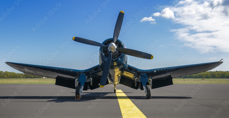

Now if you are flying at 400+mph there is a drag advantage if the wing joins the fuselage at 90 degrees, like the inverted gull wing of the Chance Vought Corsair fighter, although in that case it also allowed the undrcarriage to be a bit shorter and still give ground clearance for the biggest ever fighter prop so was deemed worth the construction difficulty.
