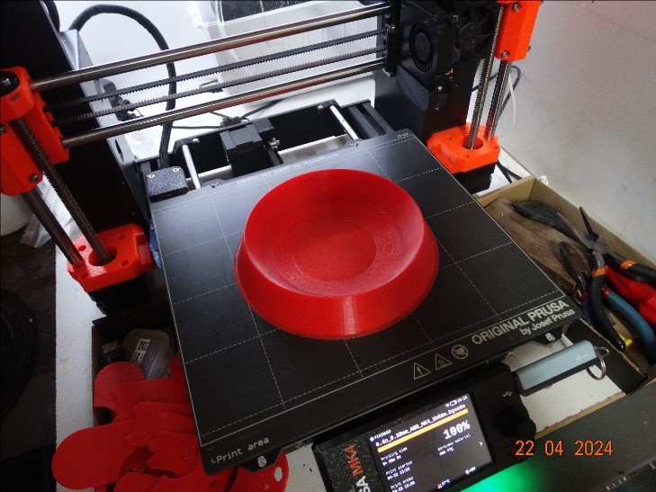

22 Apr 2024 18:43 #62 by Klipkopwildlife
Replied by Klipkopwildlife on topic 3D printing Widgets
This is a 170mm dog bowl, perfect print but only when I gave it a inside and outside brim of 3mm. One of the contributing factors could the the ambient temperature, today it was 27C in that room. The other thing is that the first layer is laid down at 100C bed temperature, all subsequent layers go down at 110C
