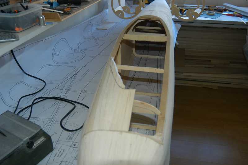

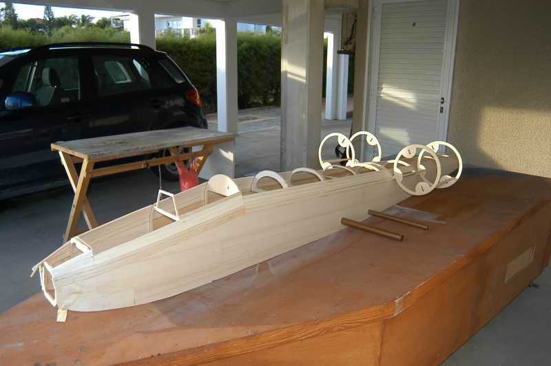

21 Nov 2012 01:45 - 21 Nov 2012 01:46 #48 by THE BLACKBIRD
Replied by THE BLACKBIRD on topic Re: The Cyprus A10 THUNDERBOLT

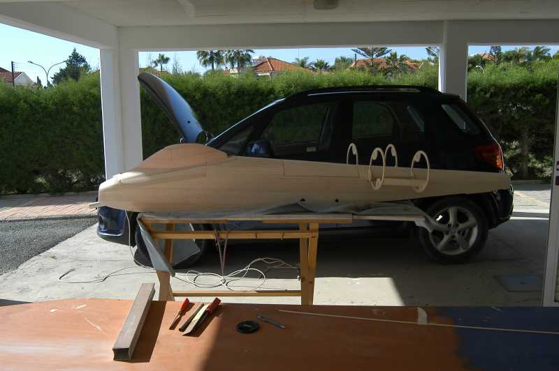

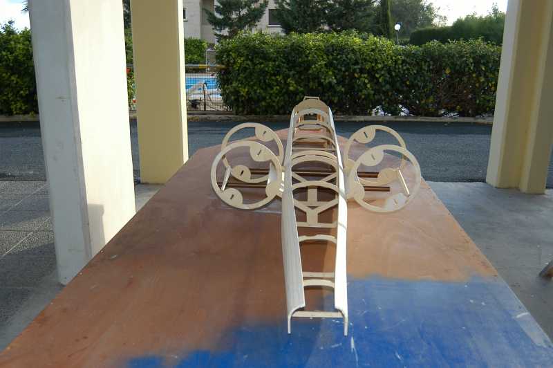

Start of the planking, formers for the tank hatch
and wing tubes, they seem a long way back, c/g just behind the front tube

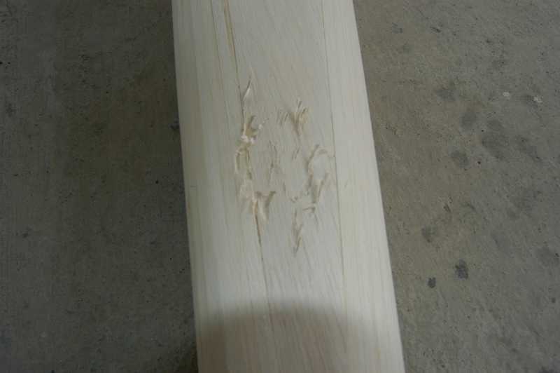

23 Nov 2012 00:05 #50 by THE BLACKBIRD

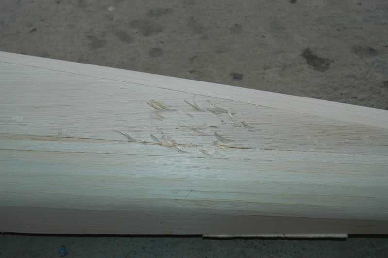

We have a big ginger cat comes round morning and night for his food i like to give him
i fed him this morning and by way of saying thank you
The b
d did this to the A 10
:woohoo: :woohoo: :woohoo:

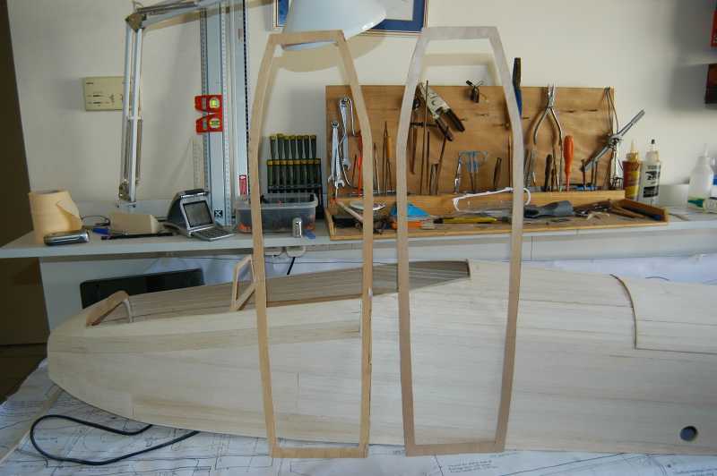

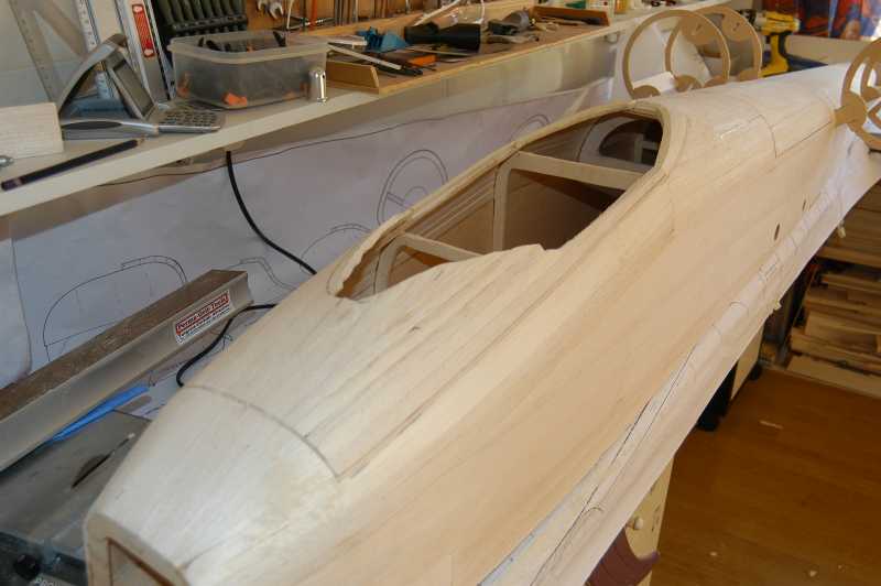

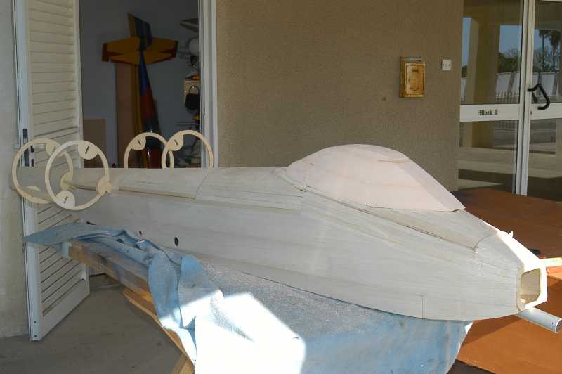

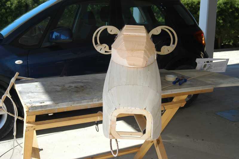

27 Nov 2012 01:21 - 29 Nov 2012 23:25 #53 by THE BLACKBIRD

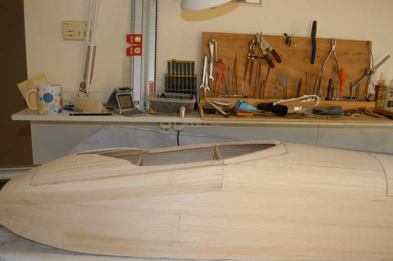

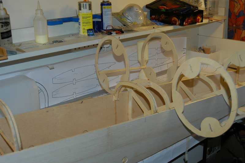

Got a little more done on the A 10, The front hatch for radio/ batteries air tanks ect
Formers for the hatch
planking
And contentment again, dont they grow

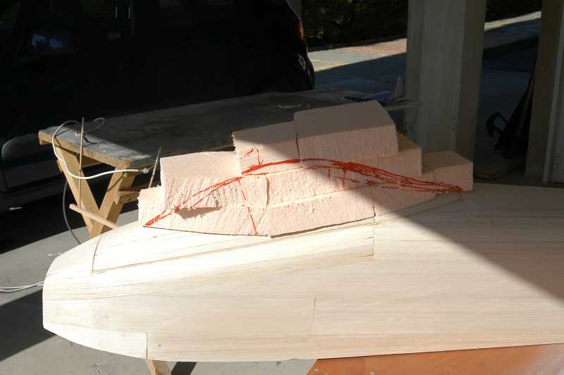

28 Nov 2012 00:46 #56 by THE BLACKBIRD

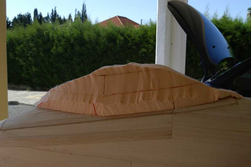

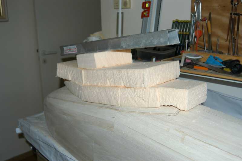

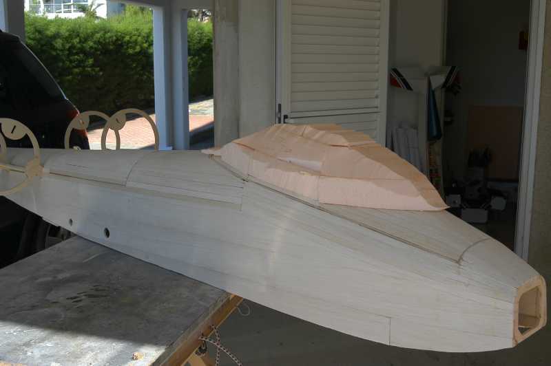

I have never worked foam before but had a go on the A 10 cockpit canopy as i have to mould my own
STuck a few lumps together from the sheet that Pol gave me at the nationals
Thanks: The Beard

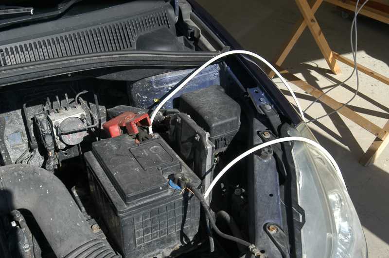

28 Nov 2012 00:52 #57 by THE BLACKBIRD

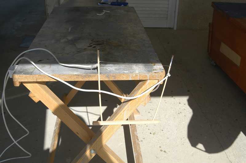

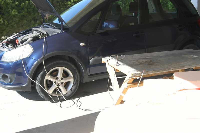

Then i made a hot wire cutter from a bit of wood, dowel, 30amp fuse wire and a length of cable i had
I then connected it to the car battery
Thanks: The Beard

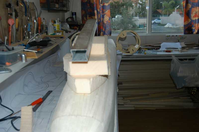

28 Nov 2012 00:58 - 28 Nov 2012 01:01 #58 by THE BLACKBIRD
I marked the outline on the foam
Then i roughly carved the shape
Well i did say rough
Last edit: 28 Nov 2012 01:01 by THE BLACKBIRD.
28 Nov 2012 01:07 #59 by THE BLACKBIRD
Then started sanding
Thanks: Dean M, Ex-Member, blue123
