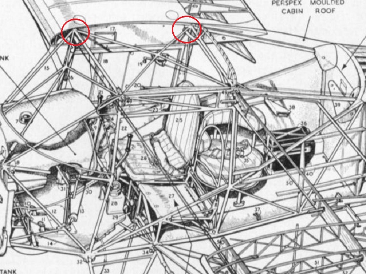

Andy i have a question.
the rear seat, is it on legs or just on a block from the floor.

09 Jan 2014 19:00 #188 by Quorneng
Replied by Quorneng on topic Auster mk5
The seats sit on a low welded tube framework.

09 Jan 2014 20:42 #190 by Ex-Member
Replied by Ex-Member on topic Auster mk5
According to the wife, Tony, the rear seat in G-BXKX is a civilianised bench seat that sits on four short legs (one at each corner) with diagonal bracing on the side and rear (it may be an inverted 'V' brace at the rear). The legs are fixed to a false wooden cockpit floor.
The front seats are similar to those in Q's diagram above.
